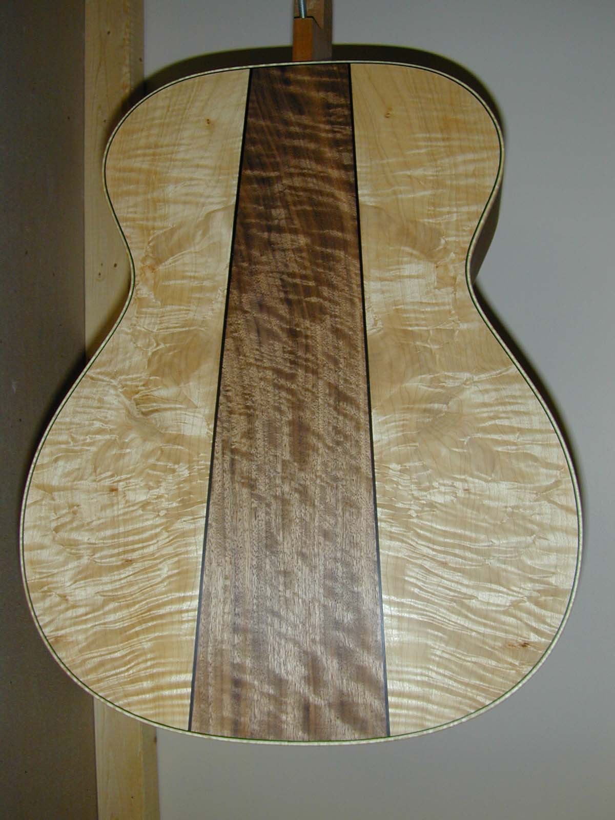

Here is a back of one of my early guitars ... definitely more flamed, not curly IMO.
PostPosted: Fri Aug 18, 2006 2:39 pm
